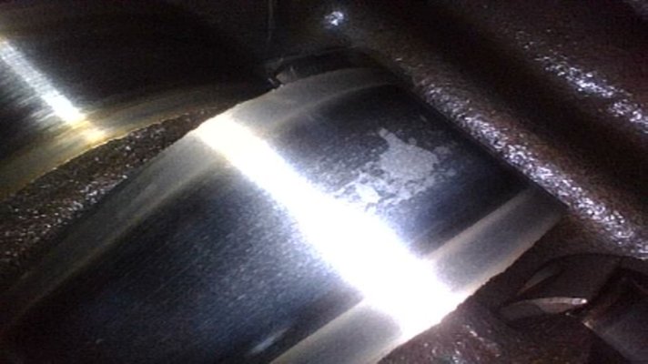

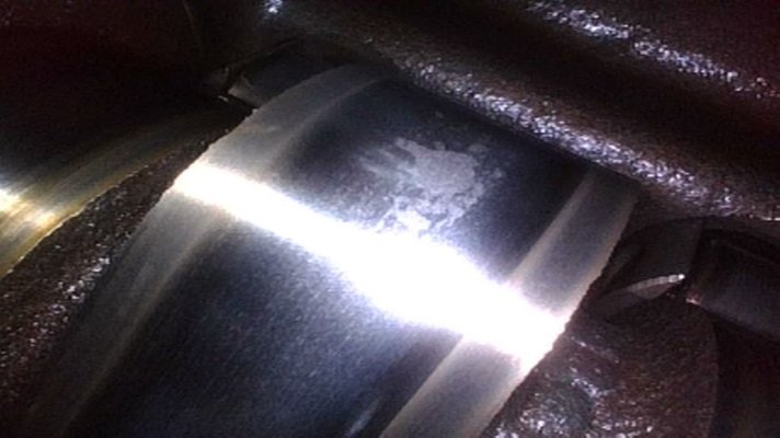

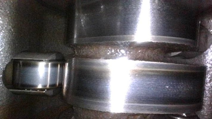

yes oil pan is off I have more time to work on it now new pics lobes starting to flake for sure

It doesn't look that bad. With good maintenance and oil changes I would run them. If you got time and the money laying around, then sure why not, but I think they still have lots of life left.

money is always a issue but if you use run a pic on the cam in those spots you can really feel it flaking. it will build up on roller/ get into the rollers better to replace it now than later when it's in the truck I'm in my sixty's don't just hop up there like I use too :cool:

Yea that cam will give you issues in short order.

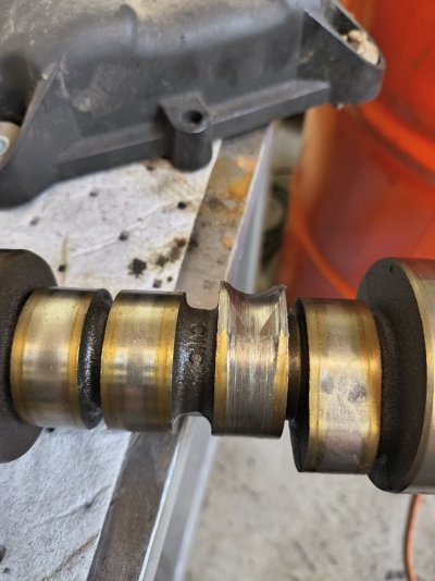

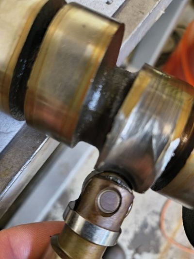

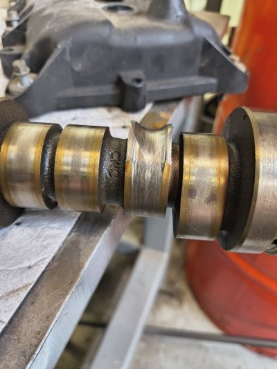

so taking my 260000 mile 5.7 apart intake lobe wiped the retainer yoke for lifters very loose will not hold lifter any more look's to me that the lifter turned in bore. because of radius on cam IMG_20250726_092624085_HDR.jpg

Oh, dang. Yeah, that one is toast. Did you not see that with the scope? I don't like the design of that plastic lifter retainer.
That sucks, man. Such low miles. What oil were you using?

Hey Quikkota that picture of the cam is from my motor with 260,000 on it . I picked up a motor , eight HP 75 trans , transfer case front drive shaft .that is the motor you saw in the earlier pictures that one has flaking on the cam he told me it had 47 thou on it . Russell at sound German is going to have a wiring harness in a month and a half I'm putting that 8 HP in there going to need a tune anyways I'm trying to get everything in place to just swap over you read so many things get rid of the MDS keep the MDS. I think it is just poor quality materials myself you could pull my dipstick at 3000 miles and it look like I just put oil in there.that intake number two nothing to do with MDS. if I'm going to get a tune I need to wait to get it tuned for the 8 speed not the six speed that's in it. I'm not just using it for towing it's my everyday just wanted it a little more out of it course with the good cam I'm sure it will have better performance.
