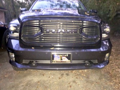

I added the factory tow hooks to my RAM Sport recently. I had to remove the lower grill and cut out rectangular holes for the hooks to pass through. The hooks sit close to the bumper, but there is plenty of room to insert a flat tow strap.

The hooks face out. Yes they fit facing out. It’s close to the bumper but do not rub it. I had them installed on my express.
Just take a utility blade and a heat gun and cut a little at a time. I do recommend getting some edge guard to clean up the cuts.

Wow that looks great! Super glued it to the insert? Had to pop the insert out? Think you got a different insert but I'm definitely doing that. 1/8th" trim?
Thinking about either hole saw & hack sawing it to create nice oval, heat gun and cutting, or tiny hole to squeeze just the hook through at an angle not the whole width of the hook hole.

Hmm. Yours looks great! Some seem to completely be right on the bumper not sure why. Looks like you got a good amount of space. Clean cuts too. Sorta thinking I want my hooks facing out though.

Thanks! I user a Dremel tool with the flat cutting wheel to make the cuts and then used a file to smooth the edges.

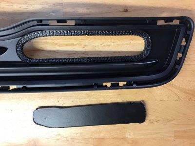

As shown in the pics, I removed that plastic piece, it's easy to remove and you can do a better cutting job with it sitting on a work bench.
The back side is smooth so I just took a marker and made an outline of where to cut and cut from the back.
If you mess it up that entire insert is only like $30.
If I were you I would wait till you have the brackets
