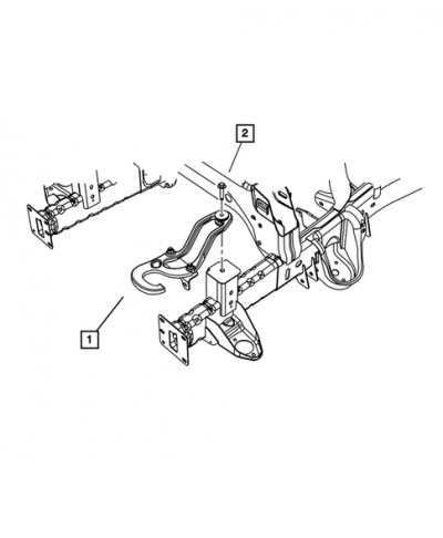

This part says it fits my vehicle yet I for some reason highly doubt that based off Amazon reviews and another sites reviews. Doesn't seem to be made for my vehicle? 68196982AA
Can't figure out which tow hooks everyone is using as well.

That just looks like the blank filler which should be what you have already. And new tow hooks seem to be hard to find. Most likely due to the 5th generation trucks coming out. If you check ebay I saw a few sets of used hooks for around 200$ or you can see if any junkyards have 4th gen trucks with tow hooks.

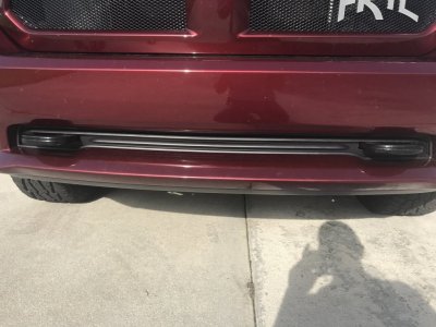

It's actually with the cutouts. Better picture on another tab I can't find now (got 200 tabs open).
Damn, ain't nothing available or easy for this haha.
Attachment didn't load for some reason.

Check now i think I fixed it.
Edit: that insert is for the metal bumpers which is a different shape and size
