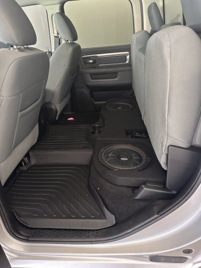

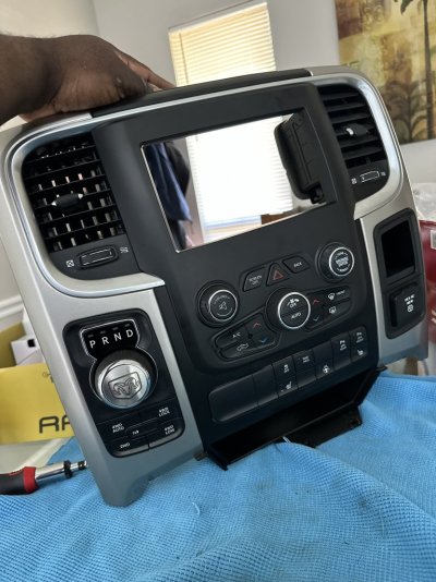

I just installed two kicker cvt 12” on a kicker cxa 800.1 in my 2016 ram 1600 big horn 4x4 I got last weekend, using the pac ampPro device. And it sounds like pure D ****! The bass is muffled and no matter what I do I still kinda get highs coming thru my subs. And when I turn it up past half the bass is super weak. This same setup sounded amazing in my f150 with the pac ampPro. So I would appreciate if someone could hopefully help me understand wtf I’m doing wrong here.

Thanks man yea I checked all those things. I’m just gonna scrap the 8.4 uconnect Tuesday when the new radio and maestro box gets here. I literally took it all out of my f150 Monday morning and put it straight into the ram Tuesday left all my amp settings the same.

Yea I just uninstalled and returned it. After checking software and dipswitches I figured it was the unit. I’ve been installing sound systems for 20 years so I quadruple checked everything. I just said screw it and ordered the “10 floating pioneer NEX head unit and the idata link maestro module and dash kit. Should be here tomorrow evening

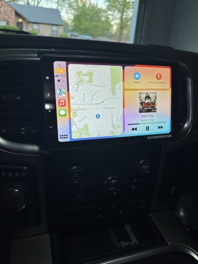

Alright everybody I put in the floating 10” pioneer nex display and now everything sounds great subs shaking the entire house did my time alignment and everything sound sloping and all. Didnt rewire subs nor adjust amp from my previous truck I took it out of so I’m thinking it was ampPro. I also used all maestro idatalink equipment this go round

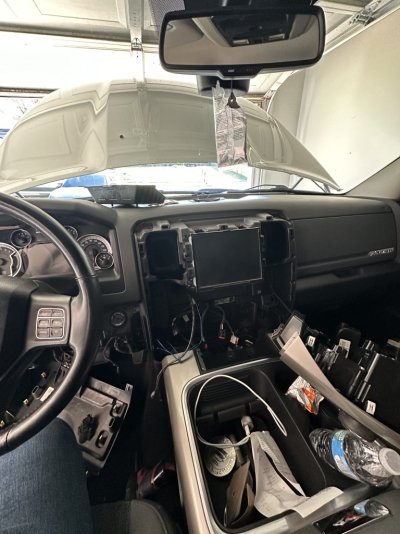

Found shortage in the camera wire from new radio harness everything works now
