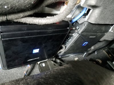

Finally The Build is complete!! I call it the Kicker/Alpine 900 watt up Build. Total cost is roughly 1100 dollars for 900 watts. Below is the list of items involved in this build. You can crank it wide open no distortion! Its budget build that Rocks for Sure!!

The resistors are on the signal input side not the speaker side. The harness was plug n play and had enough wire to reach the back of the truck. Alll I had to do was connect speakers wire to my amp and solider my Jl rca to speaker wires and high input harness to the Netaudio harness. Real simple! I run my stock unit at 0 for bass mid highs. Only time I have to bump up the bass to 4 is if I'm listing to country or rock. That's just to get my sub tab bit more kick. Rest of the music is set at 0.

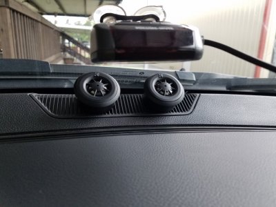

**** 3.5 inch kicker KS have been removed and Replace with
Kicker 43CST204 3/4" Titanium Dome Cs-Series Car Tweeters
Do not amp the 3.5 they will way too loud n harsh!! Tweeters sound much better as u can see in the pic below i set them up in the where the center speaker grill.

I dont have pics atm, but i ran the net audio on the passenger side door. I have lc7i power( 2amp in line fuse) and ground ran off my sub amp. Lc7 turns on with the signal from the speaker inputs. I ran remote out from lc7i to both my amps.
