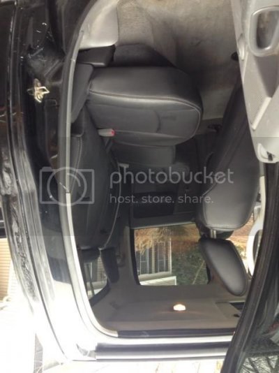

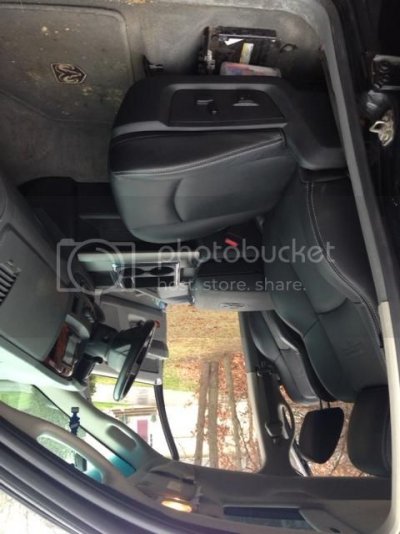

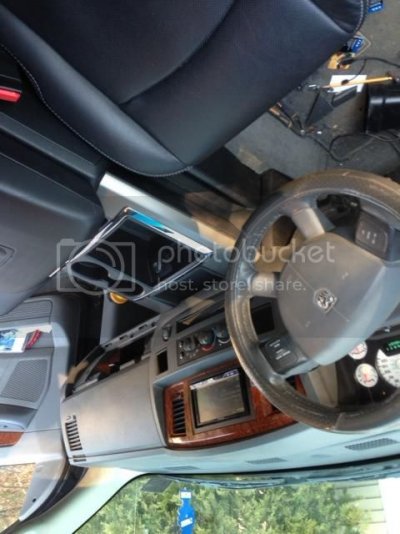

I know this is something most guys want to know if it can be done before spending a boat load of money on something. Here are some pictures a customer sent me after buying a set of seats and console for his 08. He said he had to trim the opening in the dash a little but overall it is a solid install and looks great. This will let you get new truck feel without the new truck payment

pretty nice
