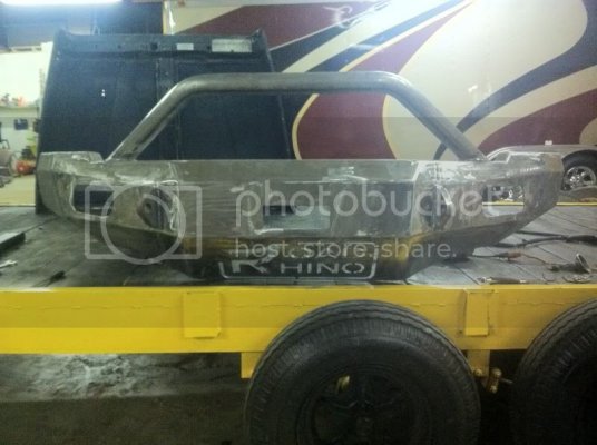

alright sorry I was at sema last week so I finally got back to work on my bumpers again. I go the front fitted last night. Here are some pics

Bad ass man , you will love the bumper I know I did .

Are you going to do black paint or will you rhino line it?

Sorry its been taking a while Ive been at school and work but finally got it off to get lined this week Im so ready to get it on!!! You will also see that I cut out holes for the factory fog lights. Looks sweet!!!!

Looking good
