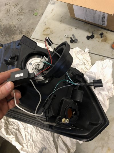

I bought some H1 projector headlights that have one single bulb for low beam and the cutoff shield for high beam. They were plug and play into my ram, great- they work awesome

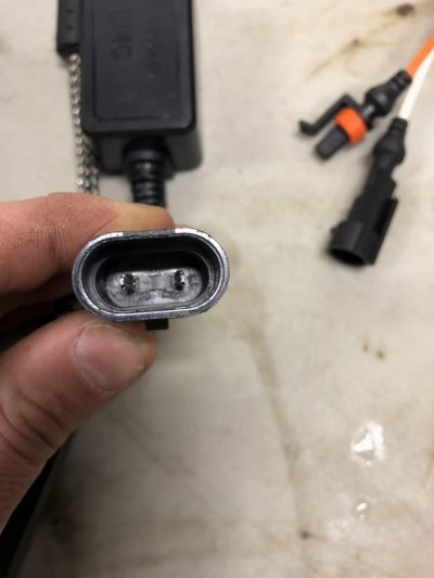

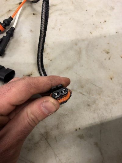

I bought an H1 hid kit off ddm tuning to fit into these headlights. It just arrived and the connector I’m seeing has only two prongs. Rather than the ram harnesses 3 prongs. So I’m assuming I now need a harness adapter to go from my oem plug to this hid kit plug? Anyone recommend one?
Next question is how do I wire these ? Plugs everywhere haha. I’m a little confused. I also will probably need to tap the two wires for my projector solenoid. What do I tap them too? And what is this box that looks like a relay or maybe a capacitor? (Attaches to my headlight solenoid)

The orange and white wire from the bulb, plug into the ignitor coming from the ballast. That will light the bulb.
The black and white wire with the plug ends goes to the projector shutter solenoid for high/low beam function. The high beam splitter would plug in between the OEM truck harness and the ballast and then to the wire going to the projector shutter solenoid.

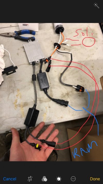

How’s this for a technical drawing LOL
So from what I’m getting. I need a Ram male 9006 to a female H1.
But as for the low hi splitter I’m not sure what one I need. a6d6e91d035cc0e6bf8cbdb08f970647.jpg

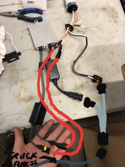

The light grey Y harness would be the splitter. The dark grey would be OEM harness from the truck is what I am thinking is how you'd have to run the wiring. The Y splitter would send the high beam. Signal to the solenoid
I'm sure I will be corrected if.i am wrong. But I think that is how yours is supposed to work....2ce73462f54fa49d0946d0b7b0f43226.jpg
Don't think I am being an idiot, it was a long day for me, but I read your RAM as RAW.....sorry....LOL.
Yes, that's it.
