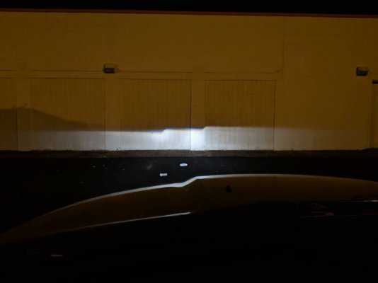

I would be i terested in beam pattern pics against a flat wall and perhaps impressions of brightness compared to stock quads if you could pretty please.
I have been seriously considering finding some lights like this as I drive 80 miles of country winding roads, no streetlights, lots of deer, wet/icy often.
Sent from my SM-G892A using Tapatalk

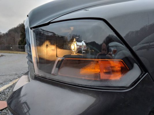

I didn't take any before pics with my quads...5f63be33f9ba3f509a410f364c0d680f.jpg344e8372de0fbc8b30c0ae9ad8298e2b.jpg763c5ac0a4bdffe75258c06323ef4926.jpg608656d4b73442be4b59c47e351dcf3d.jpg8b61c8f6076ed442ba5a8ab2fcf6cef9.jpg
