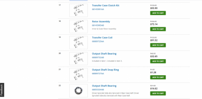

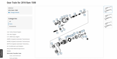

I found these schematics from the Mopar parts, maybe both transfer cases use the same part number for the clutch pack, but definetely the internals seem way different and the clutch pack arrangement seems different too. I wouldn't worry about the 44-45 burning the clutch pack. They may have changed the clutch material after 2016, hopefully they made stronger :) who knows.
This is the 44-45 TC, #17 in the diagram is the clutch kit for the 44-45
The 44-44 have a bunch of them? #18 in the print screen, and they're a lot more expensive as well
