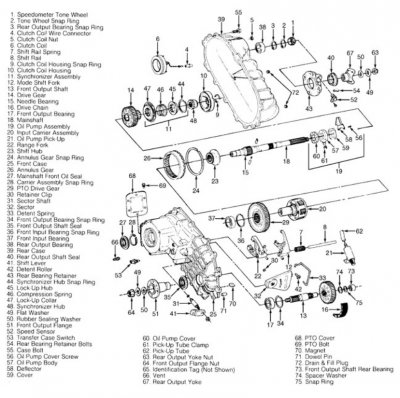

8711E32C-DD91-403E-8866-E395FC4576F7.jpeg 8BCA9300-CACB-4384-9953-AFE176A102EC.jpeg
The front diff carrier is stationary. The passenger stub shaft is going 630rpm backward. The passenger axle shaft is going 630 rpm forward. How do you reconcile that in 0.000 time without a clutch.
I don’t know, I’m just saying that’s how it worked in GM trucks of that era, Ram used a similar Cnetral Axle Disconnect for a while as well.
maybe parts 4-6 on the front output? But it is a load bearing clutch, so I dunno
EDIT- had it backwards, sold the truck 9 years ago... shift tcase then diff. No clutches.
