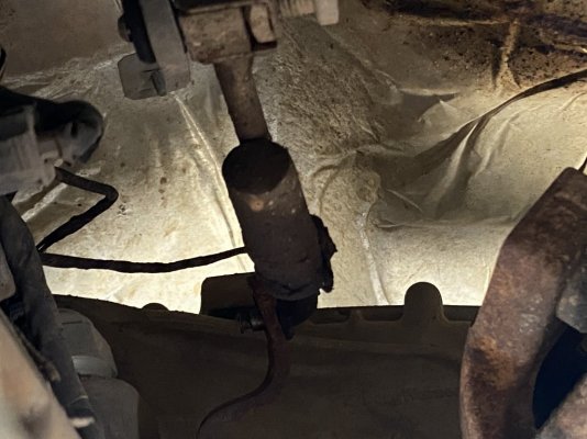

FA56CD19-AF54-4D31-8465-B155D90AA0AF.jpegWhat do you call the part I need to fix this?
Noticed this weekend that I had a LOT of slop in my 4wd shifter. Crawled underneath to check it out and noticed that the arm that connects the shifter to the t-case was barely hanging on. Looks like it needs a bushing or retainer that is missing. Just looking for a part number or a proper name so I can find one. Thanks!
PS, sorry for the crappy picture.

Can't really see in your picture, but it looks like you're missing a linkage bushing grommet. It's pretty common for these to wear out and tear. Here's a link to a set on E-bay;

Thats likely it. Looks like there should have been a bushing or retainer there. Is it the same for all years, or is there a difference on newer models? Im seeing most online go up to 2010. Mines a 2015.

Dorman bushing 14078 shows it fits 2004-2018. So I'd say they would be pretty universal.
