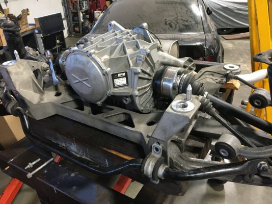

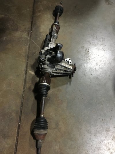

Swap the drivetrain and suspension while you’re at it.Just ask anyone who is a horsepower junkie but not independently wealthy.I know my 6600lb.slug is at its limit just from a simple blower and tune. But ive been pouring/dumping money into a vette ,but I’ve seem the drivetrain on my truck and it’s puny,and overrated.B1F2F89E-6890-4AED-82F0-DE4F8859E940.jpeg80D1F392-F4A4-49D1-8BFA-FA346C17C344.jpeg8DE5C621-1CCE-4FA9-BFE2-D441B2CE3A6A.jpeg
