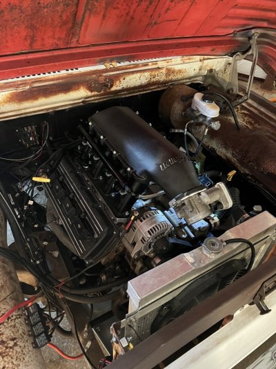

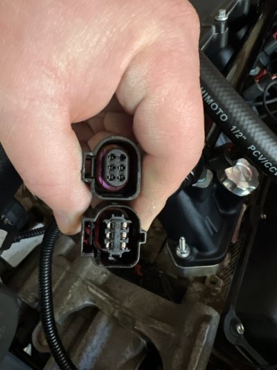

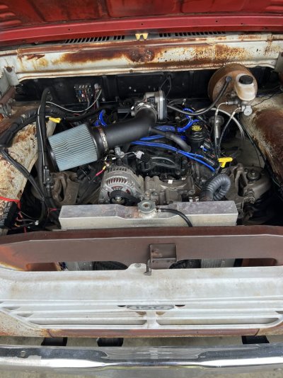

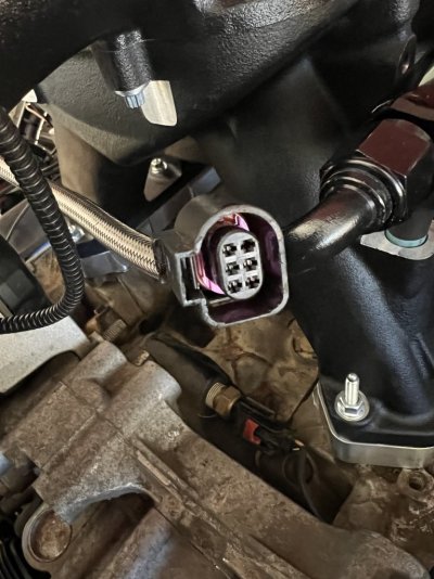

I have a 1963 D-100 swpetline and it has a 5.7L hemi from like a 2004 truck. I just put a Holley tunnel ram and converted to the late model valve covers and coils. My issue is that putting the tunnel ram has moved the throttle body forward of course but the harness is now short and doesn’t reach. I am worried to cut and make longer because it could cause signal issues. So I was trying to find someone who makes a harness extension. I have ordered three different ones and all have not fit the plug at the throttle body. It is a six pin stacked connector not a late model flat connector. Any help or info would be appreciated. Pictures added for before and after. The two plug picture is the current plug and one of the harnesses I bought so you can see the difference. Also yes I already moved the radiator forward and everything there fits.

What's the difference between extending the wires with the correct gauge and adding the harness? Both are doing the same thing (extending the wires). So if one causes a so called signal issue the other will too. I'd just extend the wires and see. I doubt it'll cause any signal issues.

Unless you have a big cube / stroked high compression 5.7,that intake isn't doing you any favours. If lengthening the harness worries you,go up one or 2 sizes on wire gauge,and use good quality wire.

Thank you for responding. That is what I did. I cut and lengthen the wires soldered the connections. I was just afraid of a signal issue with doing that. I know the dodge throttle bodies are very temperamental. I put the intake on just to change the look in the engine bay. I was going to the speedway stack injection with a Holley terminator x kit but then I would have to change the trans because it is not supported by Holley. So I did this instead. Not looking for real performance gains. This truck just a good driver and car show truck. I have a 64 sport fury with a big block 440 in it. It’s my go fast car right now. Which is still slow. One day I’d like to build a duster drag car. Or do a late model ram 1500. Here is a picture of the truck. IMG_8512.jpegIMG_5584.jpegIMG_5452.jpeg
