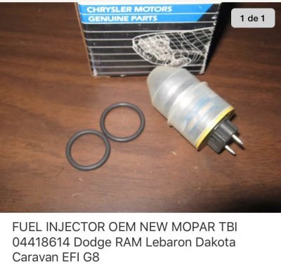

i think i might be looking for something like this

It is a TBI fuel system, it only uses 2 injectors as far is i know, that is why i want to know if they are the same for the 5.2 and the 5.9, because the injectors are inside the TBI.

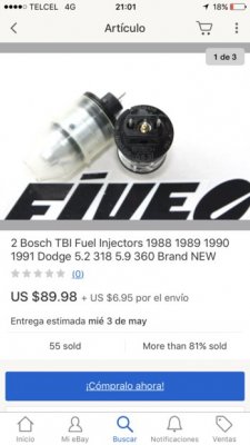

Found these on e bay, but won't to buy them until I am sure are the correct ones

Thanks for the info, don´t know why that eBay ad says are the same.
if what you say is true, the 5.2 injectors would fit on the 5.9 TBI, but not viceversa. then i will just have to find out if mine are 5.9ers or 5.2s

Just realize you said "rail" in your post, my truck is not mpfi, so there is no rail, i have a EFI system that uses TBI, although it is a 1996 didnt come with mpfi, so i guess the ad on ebay is correct, 5.2 and 5.9 are the same
