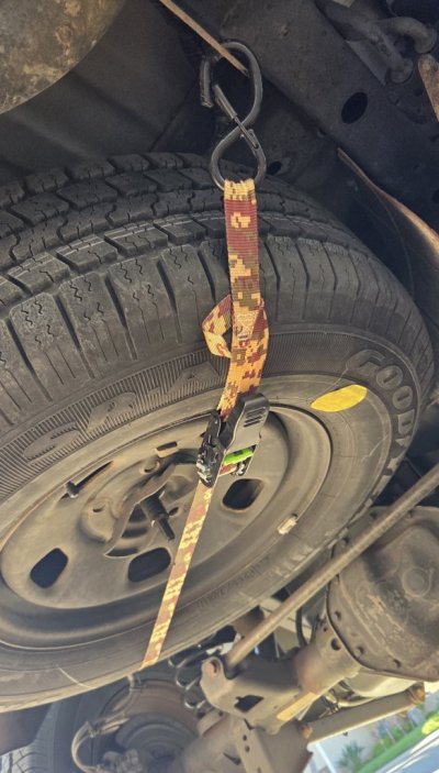

It's also a good idea to occasionally inspect the cable mechanism that holds the spare up. I had a 2000 Ford F150 and I never did that, and then at about 15 years old the spare just fell off one day. Luckily it happened on a surface street, when I was just taking off at a stoplight. If it had happened on a freeway it could have been deadly to someone behind me.
I replaced the mechanism, and added strong straps to hold the tire up in case it failed again, until I sold it.

By the way, this is what I have on my Ram. The hoist is in perfect shape, and I do check it occasionally, but I put one ratchet strap diagonally across, and if I back off the hoist it's strong enough to hold the tire up. Just a little bit of insurance. The strap I'm using has spring locks on the hooks, so if the strap broke, they wouldn't fall off.
