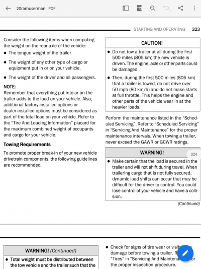

My 2020 ram diesel has that verbiage in the Manuel but it's not for diesel engine it's for the meshing of gears and such . I followed that's recommendations, I figured 1000 miles of easy driving was very little to do in the Grand scheme of things

If the Cummins supposedly needs no break in what is the reason?
The first 500 is to let the drivetrain "break in". After that best thing you can do with a Cummins is put a load on the engine and drive the snot out of it. Even more so that the latest revision of the engine uses a lower tension piston rings. Keep in mind that a CTD is actually a medium duty truck engine and put to work right away in trucks with GVWR over 30K lbs.

Here's is a screenshot of my Manuel, it solely has to do with towing

That's exactly what mine says.
I'm sure allot of folks don't head the suggestion but i figure 1000 miles wasn't to much to comprimise on with a $90k truck. It may or may not make any difference, but I feel better about doing and figured it was printed in there for some reason
