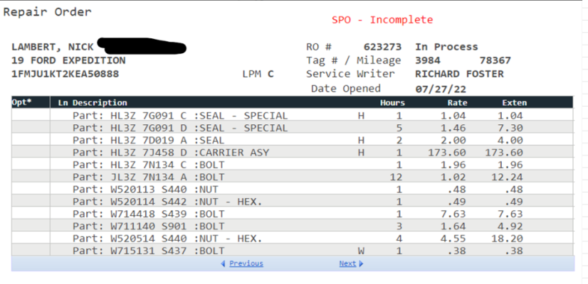

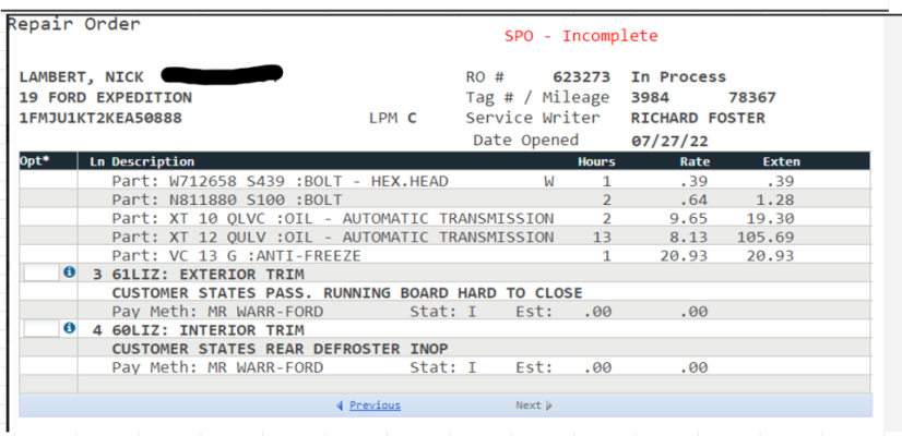

Warranty calls for the absolutely bare bones replacements. Pretty typical. They're eating the cost, so they're not going to give you anything extra. That's not saying they didn't slap in a complete reman trans but part of warranty requires a teardown, inspection, and report to the OEM of exactly what failed. If they determined that there was only 1-2 failed components and everything else checked ok, then that's what warranty approves. As a service writer, I've fought that battle with Navistar, Allison, Spicer, Cummins, Caterpillar, etc.. As a customer, I fought this with Ford. They're all the same.
This is exactly what happened on my Expedition. When the 10-spd failed, they determined that the parking pawl assembly and the CDF drum were bad. Even knowing that this was the beginning of a common issue with those transmissions and that the parts themselves had a flaw, Ford determined that it just needed those parts again with some slight tweaking.
They redesigned them, sent them through manufacturing, and shipped the parts 2 months later. The parts physically wouldn't fit, so they changed the design again, sent them back into production and shipped us parts that fit. Down for 6 months before we got it back and it drove exactly 88 miles and failed again. Ford determined yet again, that they weren't replacing the entire transmission and wanted to just replace the outer shell. We wrote a $14k check to walk away from it. Wouldn't you know that now there's a recall.
It happens all the time.
