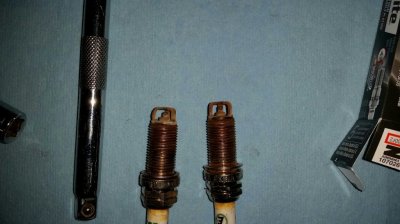

Ok. I'll see what plugs did to it. Here are the plugs that came out. Double platinum going back in. O'Reilly said they are oem. uploadfromtaptalk1422935586224.jpg

I'll bet that makes a difference. Thumbs up on O'reilly's. They will get you the right parts.

All done. 2.5 hours. All were worn out e3 plugs like the two above. I ended up just taking off all the coils on that side. Climbed up and did it. Then with 4 to go my plug socket quit grabbing the plugs. I had to put a washer in it to grab good. And the 1/4 ratchet was my friend. Previous plugs had no antiseize on them. I feel lucky. Now how long will the platinum last? That was a *****.

That is correct. Those e3 plugs are garbage anyway. Not good for a hemi

well, Good news. the issue was not in the transmission but in the engine. The misfire detected in #6 along with the plugs caused the shuddering when placed under load. taking it out of overdrive masked this symptom.
