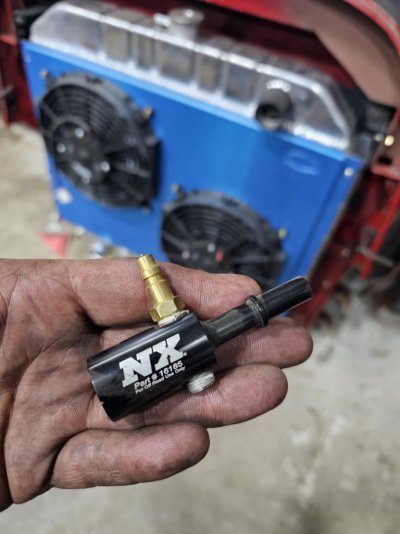

I got one of these kits.
not sure how it's going to hold up long term, since i've only used it once in the last year.
At this rate, i'll die of old age having used it about, twice.
though, if someone wanted to go as cheap as possible, this version would probly work too
