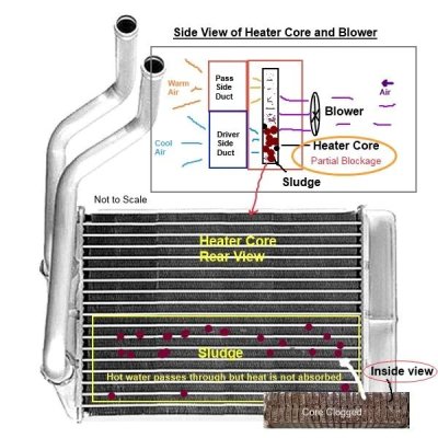

Does the truck have the dual zone automatic climate control? (there will be temperature settings for the passenger and driver)
If it doesn't have the dual zone ATC, there is only one blend door for temperature and you most likely have a plugged heater core. There's many threads on this forum about it, some have been lucky to back flush the heater core but the ultimate fix is replacement.

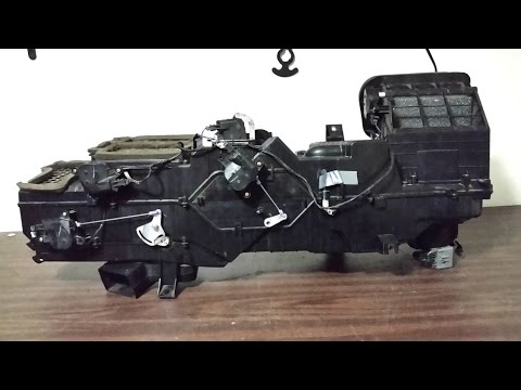

For one thing you may as well call the 3500 Ram a Generation 4 Ram
Every HVAC System has at least 4 Actuators
Most ProMaster Vans have 5 actuators
The first one is above the upper glove box, it moves the Recirculation Door
The second actuator moves the Blend Door, it is just to the left of the Blower Motor
The third & forth Actuators are behind & slightly below the HVAC Controls, These Doors are called the Mode Doors, #1 & #2
they direct the air flow to the Defrost & Floor settings.
The other door controls the air flow to the Dash Center Vents
Some day, some one that disassembles & reassembles the complete HVAC UNIT,
will think about how the Driver vs. Passenger air flow is controlled & make a Youtube video about it

I don't have the dual zone equipped on my truck but I did flush the heater core once and it was fairly clean. I would really like to tackle the replacement of the actuator but I have found nothing on how to perform the replacement for this 5th gen. 3500
Just because you didn't see gunk come out of the core doesn't mean it isn't clogged. Flushing is a 50/50 chance. That sounds much more likely than a bad actuator. If the actuators are moving when you tell them to, the likelihood of them being bad is slim. First symptom of a clogged core is no heat on the driverside.
Found this when I did the core in my 2010 years ago, there's a baffle running down the center of the plenum that splits the drivers\pass side air flow.
