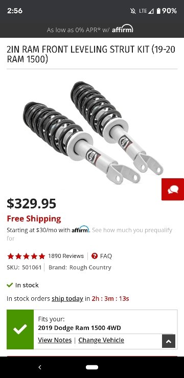

Thank you all for the input. I'm on the fence about installing the rough country 2" level kit..the coilover not the spacer. Just curious what size tire I can run with that installed and if anyone has installed that kit and your experience. Thank you! f0a07448d382d10e5757e8f311681ef5.jpg
