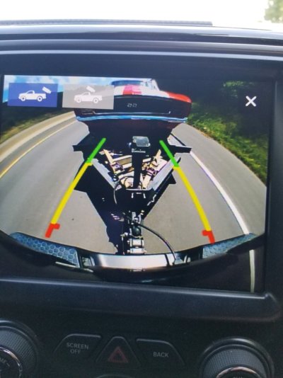

At one time there was an aftermarket set up that allowed you to switch cameras on the Uconnect screen by the flip of a switch. It would go between your tailgate and 3rd brake light. I considered it way back when but I'm not sure if it's still offered. Seems like a pretty decent set up.
There's no need for it now - in the Uconnect screens for the cameras, you can select one, and while the camera is still active there SHOULD be a button that allows you to switch to the other. On my last truck and my current truck, I have had both of these cameras, and switching between them is a simple touch on the screen.
Correct. There are 2 soft keys to switch between the 2.
