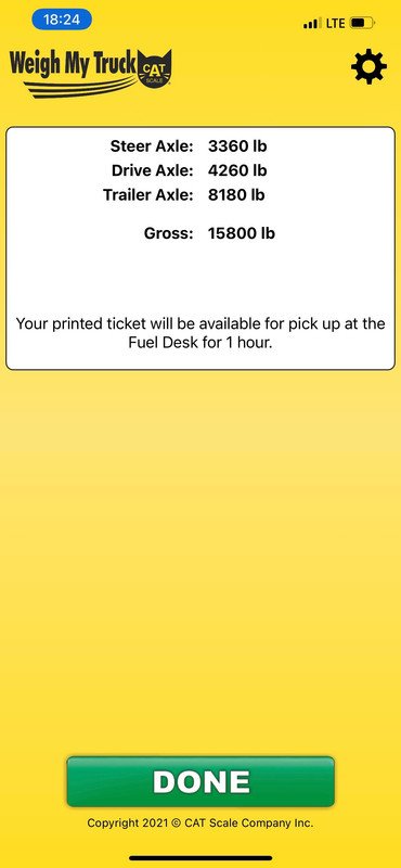

My step-son has a 2020 Tundra with GRAWR of 4100 or 4150. He weighed his 2021 Grand Design Imagine 3250BH and it weighed 9300lbs with 1100lbs tongue weight. He was over his GRAWR by 150lbs and that was with a bumper pull. Pretty sure a 1500lb pin weight 5'er would be even heavier on the rear axle and the 1500 Ram only has 3900lb GRAWR I think. And the TT was brand new and completely empty other than the 53 gallons of water the dealer left in the tank. Even with that empty he would still be pushing that GRAWR, especially if it would have been loaded up for a trip

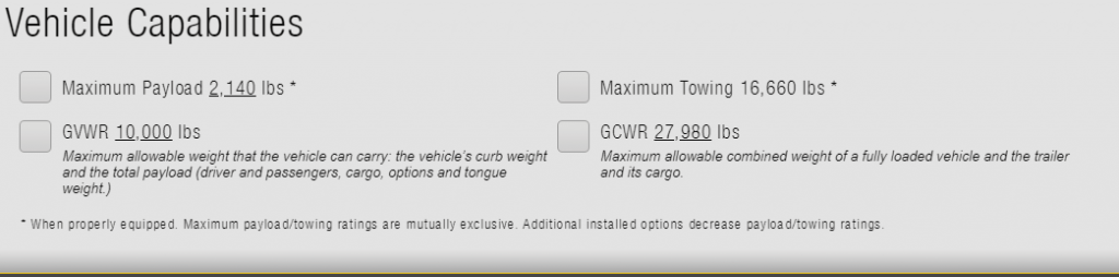

Hey guys, new here and also want to make sure I'm good with the fiver I'm looking to buy. I just bought a 2022 2500 6.7 and also am used to towing my TT. I still don't have understanding all these weights down. Due to various issues I am now selling the TT and getting a 5er. My Max payload on the dodge 2,140# and the hitch weight of the new 5 is 1995#. My first question of many is that enough extra to not worry or should I be looking at a lighter hitch weight? All the other weights seem to leave plenty of room to breathe. Any help for a new old guy would be much appreciated. Also I'm not trying to hijacking a thread here, the issues just seemed similar so thought I'd jump in instead of starting a new thread.
If your payload capacity on your door is 2140, you're not going to be okay for a pin weight of 1,995. Your payload needs to also take into account the passengers, gear, hitch, etc. in your truck. Also be aware the rated pin weight may or may not be actual once you factor in gear in trailer plus accessories added that weren't part of the rated trailer, like if the dealer added some items at their lot.
Best thing to do is load up your truck like you are traveling including hitch and people. Then go weigh full vehicle and subtract that number from GVW number on your door jamb. Then you know the actual remaining payload capacity and purchase a trailer accordingly.

one of my nephews pulled his 32' bunkhouse travel trailer with '16 Tundra and the truck bed was packed with firewood and coolers full of drinks and I remember that we were all amazed when they pulled up at the campsite. I know he was way over on every measure but he always said it pulled fine but sucked gas and had a small tank.
He only towed his a few times with his Tundra. He sold the TT a couple months ago. His trans temp came on when moving the TT around the campground. Just too much weight for that truck. It was rated to tow 9800 and his TT weighed 9300 but like said, trans temp warning came on and he was 150lbs over GRAWR.
Here is his CAT scale slip. He didn't get an empty truck weight but we did get the tongue weight from when I towed it and that was 1100lbs

I don't have my truck yet, I was given this from the dealer.
I did run my VIN on Ram's site and the numbers came up pretty much the same.
The trailer numbers are
Dry Hitch Weight (lbs)1,995
Unloaded Vehicle Weight (lbs)10,580
Cargo Carrying Capacity (lbs)2,120
Gross Vehicle Weight Rating (lbs)12,700
Gross Combined Weight Rating (lbs)15,700
I was hoping to have the trailer bought when I pick up my truck in a couple of weeks, I have a job I'm traveling to.
I guess I need to find a lighter trailer. Thanks for the heads up. I'm just trying to get the biggest trailer I can tow comfortably although it's more a destination trailer, I won't be moving it much I still want to be within legal weights. We are going to be living in it for a couple of years and momma needs her room.
