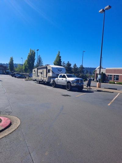

mtofell
Mar 18, 2014
3,065
3,100
Guy I sold my 5th wheel to had big tires and a lift and I was surprised (and very glad) he was able to haul it away. His truck had lots of squat with it attached and it was quite nose high but it still hooked up and had decent bed rail clearance. I'm not sure how many inches the was or how big the tires were.... maybe someone can guess from the picture.

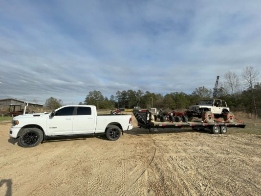

heefageLA
Dec 1, 2014
770
886
Vidalia, LA
05, 14, 17, 20, 23
Currently looking for a pop up with an 8ft box to mount to the front of my 30ft gooseneck.
Ill have enough room for the jeep, quads, and camper all on one trailer.
I only tow heavy 5 or 6 times per year so the 6.4L gas makes sense for me.
