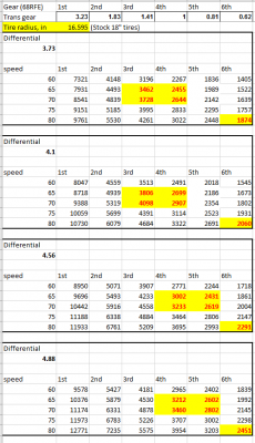

I can't wait to hear how you like the 4.56 but in My case I am staying with the stock 33's and I am debating on 4.56 or 4.88 for towing a 12k# trailer, I absolutely HATE the 3.73's

Tuffy, I did a little math. Remember, You HATE 3.73:1. The jump from 3.73s to 4.56s is approx 22.3 %. The jump from 3.73s to 4.88s is approx 30.9 %. The difference btwn the two is roughly 8.6 %. Only you would know how you drive and how often you tow. Hills? Just thought this would help.

Here is a little comparison chart I made, don't look at the first and second gear so much I know this thing won't do 12000 RPM i am just too lazy to take that out.
Anyway with my '16, 6.4L, 3.73 diff and stock 18" wheels/tires when I am pulling my 12,000# trailer I have a hell of a time staying in 4th gear (2400- 2600 rpm) any wind or slight hill at 65 to 70 mph and I am screaming along in 3rd gear and dropping into 2nd on hills.
So to me it looks like if I went from 3.73 to 4.56 I would have the same problem in that 2400 to 2600 rpm range just in 5th not 4th. of course 4th gear would be higher RPM around 3000 which it should stay in.
4.88 on the other hand would be 2600 to 2800 rpm in 5th and might be enough of a bump to keep it there. The downfall of course is unloaded going 80 down the highway. the difference is only 160 rpm's though between the 4.56 and 4.88.
Anyone have 4.88's that has any real-world data loaded and unloaded?
So I am leaning towards 4.88 but haven't quite pulled the trigger yet.
Any advice would be greatly appreciated.
Hope this chart helps those of you that are in the same situation I am.

Keep in mind, by going to a 4.56 you are gaining a significant leverage advantage that might be enough to use a lot more 5th. That's exactly how it went for me going from 3.73 to 4.30 in my 6.2.
