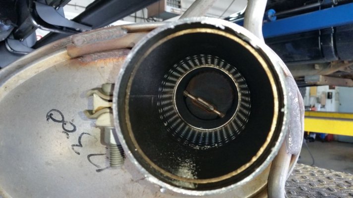

I had a 2014 6.4L CC and installed a Magnaflow single in/single out muffler, had the resonator cut off and a piece of pipe bent up to fit the space where the reso was.
It had a nice deep tone when driving around town, no drone with an MDS delete tune from Hemifever and it sounded like a beast when at WOT.
It cost less than $400 with the install & pipe section. I had mine welded but it easily could have been clamped. The only custom piece was the pipe that replaced the reso.

Inside the stock muffler:
