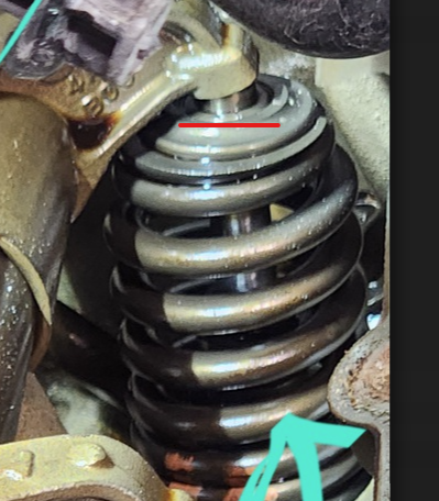

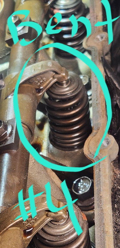

I have a 2016 2500 6.4 with 205k miles. Engine light came on one day, cylinder 4 misfire, rougher than usual idle (nothing crazy), a couple of instances right after startup of a nasty ticking, but otherwise normal operation. I took it upon myself to swap spark plugs, coil, and fuel injector with cylinder 2, same issues, same codes. Took it to the shop to have them pull the valve cover, and they tell me the pushrod in cylinder 4 is bent and sent me some pictures. I used to be a dealership mechanic, but I've never done any internal engine work, so maybe this is my untrained eye, but I can't see what they're talking about. I'll throw the pictures down at the bottom to see if you guys can spot it.
Anyway, they said an engine replacement would be cheaper than replacing just the valve, because the engine has to come out of the truck to replace the pushrods. Do you seriously have to pull the whole engine out to pull off the cylinder head? The passenger side head, which is the one with the misfire, seems pretty spacious around that side of the engine bay, like you could remove the head while its still in the truck, but again, I don't know anything about this kind of stuff. So for now, I'm just driving around with the bent valve, hoping it doesn't blow out the side of the engine. Kind of lost on what to do next, $15k seems a little steep for one busted valve.

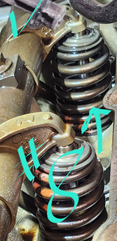

Sorry, pictures from the shop attached. Second picture is supposed to show one that isn't bent.

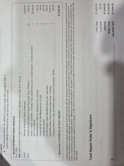

Depending on how deep into Indiana you are you may want to give my shop a call
They can do a remanded engine with 3 years, unlimited miles warranty for under 7K installed (that was on a 5.7, but I can't imagine a 6.4 is much more expensive)
I just looked at the bill, and labor was $2400
I paid a little more to get the hotter cam and valve train, plus the required tuning to make it all play nice

It does look like something is out of whack... this spring retainer looks like it isn't sitting parallel. That definitely *might* indicate a bent rod or something amiss. I would think that there should be equal distance from the retainer to the top of the rod.
That looks to be true on the others you posted a pic of.

I see what you mean....that could be what they're talking about

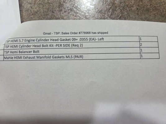

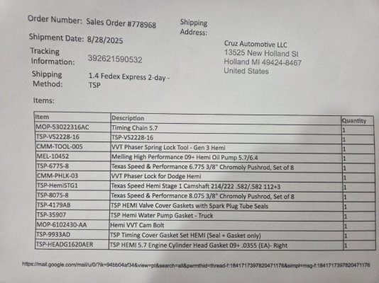

Pretty sureit was a remanunfactured long block including the heads, but then they added in the cam stuff
This is what it showed on the receipt, the first page is their breakdown, the second is the order from Texas Speed
