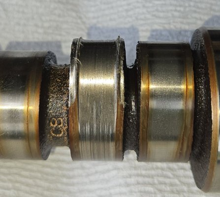

@Ken226, do you happen to know how much a cam lobe needs to be worn down to cause a misfire?
I was not yet to the point of a misfire on my Ram, but my cam was chewed up pretty good (.030 or more). I will have to measure the worn lobe and see just how much smaller it is that the others.
No, as it's different depending on the combination of the amount of lobe wear, manifold pressure and the rpm.
Consider: the piston speed is determined by the crankshaft angular velocity (rpm), so, at low rpm the piston is descending relatively slow on the intake stroke, and enough fuel/air can flow in, even through a partially open valve. Especially if the manifold pressure is high due to the low rpm, open throttle blade combination.
But consider the opposite. At higher rpm, in conjunction with a lower manifold pressure and a worn cam lobe, partly open valve, the fast descending piston can't get enough air into the cylinder. But the PCM doesn't know that, so the injector sprays the normal fuel charge and results in a super rich mixture, and it misfires.
So, how much wear would cause this would be pretty complex and depend on throttle blade position, rpm, engine load, air pressure, and probably other things I haven't even thought of. And change, as those conditions all change.

I'm gonna measure those cam lobes just out of curiosity. I'll bet I wasn't too far from a misfire.

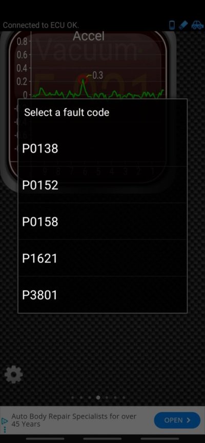

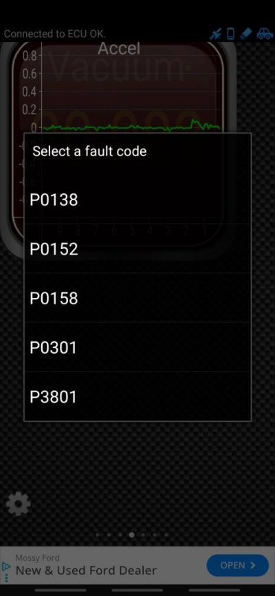

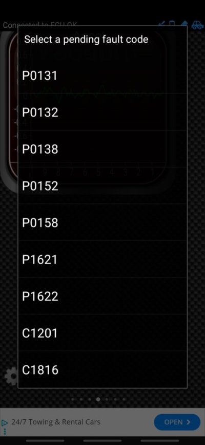

Screenshot_20260203-054459_Torque (Lite).jpgScreenshot_20260203-054410_Torque (Lite).jpgScreenshot_20251222-183037_Torque (Lite).jpgI had these rotating codes so I tightened everything that I could, and cleaned all of the electrical plugs to make it go away. Sometimes a weak battery will create issues.

This was not enough to cause a misfire, but I'll bet it wouldn't have been too much longer before a misfire popped up.
