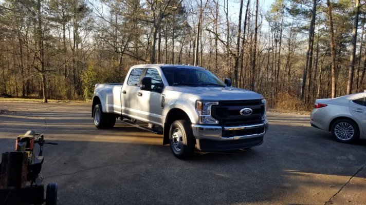

So I finally got my truck in; an F350 crew cab gas 7.3L 10 speed dually XL with 4.30 rear & 4 x 4. I put the small equipment trailer behind it (maybe 3500lbs) and my tractor with implements on it (7500lbs) and I took it from our remote property to our new house 40 miles away. In that trek, there is a 6-8% grade road that might be 1/2 mile - 1 mile long. In my first go at it, my truck made the hill at 61mph in 5th & 6th gear at about 4300 & 3600 rpm respectively. It was able to pull it in 6th gear, but the cruise allowed it to lose enough speed on the entry that it downshifted to 5th right away to regain the speed and then recovered to 6th gear at 3600rpm for the last half of the hill.
So it was able to pull 11k up a 6-8% grade in 6th gear at about 3600rpm doing 60mph. That was pretty bad ass imo, and it far exceeded the towing performance of the 20 year old diesels that I mentioned in the op that could barely manage 45mph up that same hill. I would bet a crisp $100 that it will outperform my fil's 2005 6L F250 diesel also.
That hill is the worst that this truck will see. Granted I was using the small trailer, and undoubtedly the big one would have netted a much tougher result from the gas engine. It will likely be a long time before I have that comparison.
I have video taped that pull, because there isn't enough available online for this new gasser for prospective new buyers to look at for evaluation, and when there is a video posted, some people want to say it isn't real before they even watch it. It will be a few days before I'm able to upload it.
This gas engine will be sufficient for my needs and the truck has been an absolute pleasure and has exceeded my expectations in nearly every way. I love it. Ram, time to get on the ball will a comparable gas engine! That is the only thing that drove me to buy my first Ford ever! The engine and transmission combo! I'd take a Ram with the 8 speed, but the comparable engine doesn't exist yet.
Here's a picture for your enjoyment;
