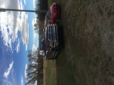

Hey everyone, new to the forum, I'm currently building up a 2013 2500 diesel and am getting ready to lift it, I'm choosing a 6" BDS and am currently running 20x9 rims with a +18 offset and 35x12.5x20 cooper st maxx. From what I know I have about a 5 and 3/4 back space and BDS recommends a 5" backspace for 37" tires. Anyone else running a 6" lift that may know if my setup will work with the lift?
Thanks!

Those wheels will work no problem but you'll most likely rub the control arms near full lock with the 37's.
