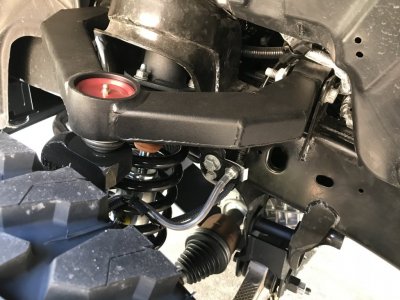

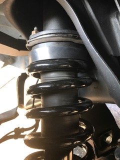

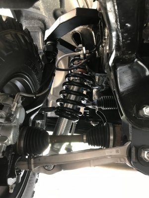

I have been reading dead end posts for weeks now. Here is my situation, which I am sure I'm not alone. I have a 2012 1500 4x4 with a Zone 6" Front / 5" Rear Lift. The front uses the Strut spacers and my struts are the quickstut drop in garbage. I would like to upgrade to the BDS 88302073 Fox 2.5 6" Lift coilover that comes with the BDS lift but I am not convinced its worth more than my entire lift cost. Option 2 would be keep the strut spacer and run a factory sized replacement like the Fox 2.0 coilover.
Before everyone jumps in here and tells me to run the Bilsteins I am not looking to go that route because I feel that half my issue is with the coil springs that came with the quickstruts. I do not have the OEM springs as I bought my truck used. Any help would be appreciated and pictures speak 1,000 words.

Don’t think anyone here is running that combo but they will bolt right up.
Joes1500
Oct 22, 2017
529
285
San Antonio tx
Bilstien 6112's
Kore off road, fox 2.0 with coils assembled .
Eibach lift , comes with coils.
These are all alternatives that will bolt right up.
Reactions: JB1

JB1 is the Man. I don't know him but the post above with an explanation and pictures is greatly appreciated. (I am self employed so I value time a lot more than most) My first instinct was delete the strut spacer because I was going to invest the money in an upgrade, so why not buy a full length coilover. I did a lot of research on that and apparently was side tracked into only looking at full length options. I was also drawn to fox because they use eibach springs. I had a great experience with their springs in the past. I think JB1 has also influenced my decision as well, especially the pictures of his set up that is almost identical to mine.

I have a BDS 6 with 5” rear coils” and I added Bilstein 6112 coilovers set to max 2.6” and they come with new coil springs. They are a larger diameter than the Fox 2.5”. You can set them for 0” lift up to 2.6”

Yes if you want the Zone 6/3 kit you can add front Bilstein 6112s or any adjustable strut as long as you don’t set it too tall. The 6” kit uses a 5” top spacer and a preload spacer. Just discard the preload spacer and set the 6112’s to the #2 or #3 position depending on your current rake (height difference front to rear). If you use front Bilstein 5100 then reference those instructions for notch/height settings, it’s basically all mathematical but it starts with your stock rake measurements.
The rear Bilsteins I used will be a little long since they were for the 5” rear coils. Superlift comes with rear Bilsteins so you might contact them for a part number. You could always use the optional Fox rear shocks that Zone offers.
