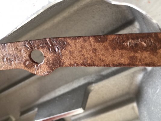

That's exactly what I have to do. I can't swing having it out of commission either. The problem I'm facing now is, I tore up the MH seal and slightly gouged the pan (on a valve body screw). I also dented the thread- on filter. I'm not a hack by any means, and can usually figure this **** out, but this one kicked my ass.
Seeing as I drilled a hole in my stock pan, and was planning on getting the drain plug kit later, I can't use it. So I called the dealer and got a replacement stock pan (59 bucks), new filter (23) and some Mopar gasket material. I'll replace the filter and put the new stock pan on in the morning.
Then I'll order a new seal from MH, blend out the slight gouge, and wait for another weekend to try again. Now I can do my homework on the Y-pipe removal and be better prepared next time.
On the bright side, the rig is getting a tranny fluid and filter change (complete with the C+).
Here's the gasket and pan damage:

Well that works. The pan is probably fine but I'd definitely get a new gasket to be safe. Sorry this didn't work out like planned but glad you're up and running!
You can also consider this fluid the "flush"...

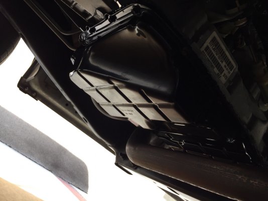

New stock pan is on, bolts torqued and waiting for RTV to cure. I'll probably wait 5-6 hours and add fluid tonight. Looks like I'm back in business.
