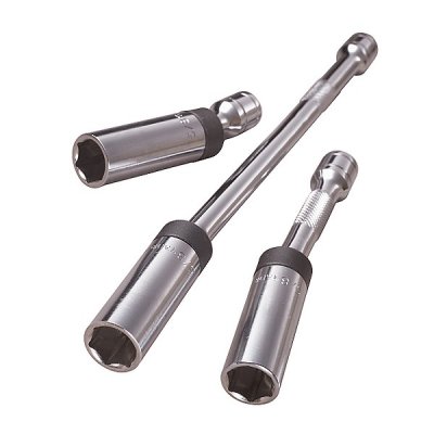

Get spark plug tool, you will need it, the one that arm bends.
