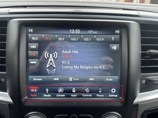

I replaced my touchscreen last October (easy job) and it worked fine for about 7 weeks. Now, the bottom row of options on the touchscreen are no longer responding. (Radio, Climate, Settings... etc) All other options above that bottom row work fine.

Just added a photo. Radio, Media, Climate, Apps, Controls, Phone, Settings. No response when touching these. As mentioned, everything above works fine.

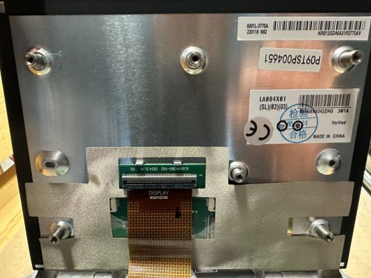

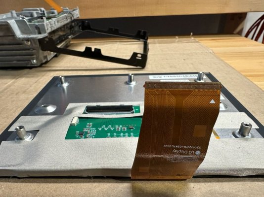

eBay will likely enforce the refund on your behalf. Especially with the shady name change in between. I'd be interested to see the back of the screen you took out if you wouldn't mind posting a picture? The way their item listing blurs out/obscures the LG brand would make me suspect "not LG" but made to look close enough to fool a casual consumer.
Definitely not LG brand, it's a knock-off. From what I can see, the only thing that's LG is the 60 pin flat cable.
Multiple pics attached.... cheers.

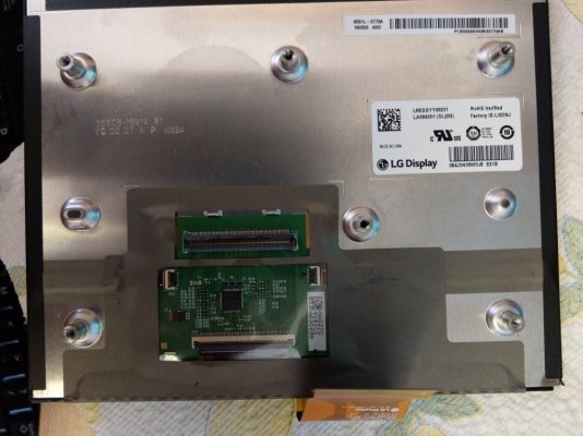

LOL, super bootleg! THis is what a genuine panel looks like (it won't have two revision numbers on it.
