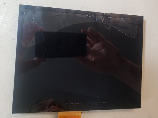

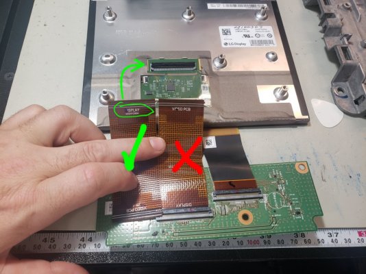

Had some issues with the screen replacement and wanted to share...
I picked up a used screen screen off of ebay for the repair and I didn't notice, but the video display ribbon cable was installed backwards when I got it. Worked well once installed correctly.
I will add that taking theses things apart and reassembling then correctly without all the spacers between the ckt boards going everywhere is a chore. After taking it apart 3-4 times to retest, it's not so bad.
---- Pictures ----
1) Original screen with LoCa bubbles underneath (cracked while practicing at removing the factory screen protector).
2) differences in video display ribbon cable orientation.
3) Finished install
