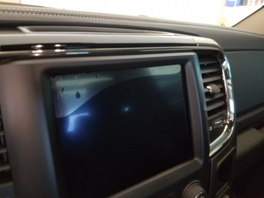

New here. Can I please get the link for a replacement screen? Mine just started to get bad this week after high temps. Thanks!

What year is your truck @ReadRyan? Yours is worse than my 2018.

I bought the truck this past March. I questioned the dealer about the small bubbles at the top of the screen and they told me it had an aftermarket screen protector on it like you'd put on an iPhone (obviously not true). I had no idea about this delaminating issue. I previously had a 2013 Ram with the 8.4" screen that was perfect when I traded it in. Today I called the dealer I bought it from and they said that they were only aware of this happening to one other customer. So frustrating.
Rav3ncroft
Jun 14, 2020
539
627
Indiana
That's what all dealerships tend to say. That's obviously not true.
I've been in contact with @RamCares and here is what I was just told.
There was a recent STAR case released in May 2021 in regard to Bubbles or Delamination On The Radio Display. Your dealer may be willing to work with you on this once they perform a proper diagnosis and consider all of the necessary information.
