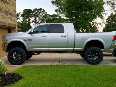

Can someone help me out what size lift does the truck have?
I been told is a 8 inch BDS lift but rear suspension looks a 6 inch lift.

Looks like a bds 8" on 37"s - that thing is fckn massive. Looks like the top of the hood is maybe 10 inches from the top of the garage.

These trucks come from the factory with a pretty substantial "rake", which means that the rear is taller than the front (this is done so the truck will be level when there is weighting the bed).
Most lifts only raise the front by the advertised amount (4",6",8", etc.), and then raise the rear enough to be level.

Yeah it is a beast I just had this lift install 2 weeks ago. The only thing is that the rear coils where not relocated under the chassis.
