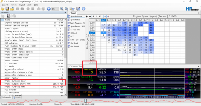

I was reading about that TSB. The Durango has to be fully stopped for it to engage 1st gear, damn it even slowing down to 1 mpg won't force it to shift to 1st :) crazy.
I have logged some of the shift chit. You can see commanded gear is 2nd, even at 1mph, trans output rpm is 48rpm, shift situation 0, shift trans mode 0 (this seems to be normal, Eco on = 512 which i still don't know what it maps to in the trans tables)
I may need to download the Beta, i'm running the latest production version 4.8.7 and i don't see the clutch shift PID

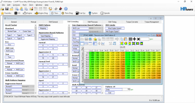

Got it done. I spent some time this morning reviewing the tables in the shift scheduling section trying to make a little more sense out of them.
Dont know if i got the interpretation on the tables correctly or not, I posted the question in HPTuners and i'm still waiting for more details. Tunning the ZF8 8 speed seems to be the best kept secret.. :)
I needed to find the Shift situation table, and i believe is has to be the one called Manual in this print screen. TCM-30001, Shift pattern manual control mapping.
I can correlate the shift situation in my logs, which is basically 0 for Eco-on Disabled, and 2 for Eco-on
With the shift situation ID i can map the shift pattern, which technically will be shift pattern 27 for both situations in my case. I'd think in the RAM 1500 will be different
Asides from shift pattern 27
The aggression / non aggression tables seem to indicate more or less a shift pattern in play as well, and the shift pattern tables are basically where you indicate the trans output shaft rpm that intructs the TCM where to shift. Again, i'm a rookie with this transmission so proceed always using common sense.
You can see from the print screen above the green tables i changed (they're green because i'm showing where the changes are from my stock tune with respect of the one i loaded up today in my calibration)
So to fix my wife 2-1 downshift i simply used 150rpm output shaft speed, all the tables below had 7 rpm before

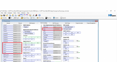

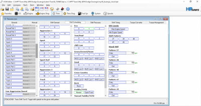

I changed:
Normal 0, 1 and 2 tables which in turn also changed aggression 0, 5 and 10 (VCM Editor did the aggression ones for me, don't know how they're correlated to each other but once i changed the normal table, the editor changed the corresponding aggression one for me)
Then Shift pattern 27 and 43, 42,44 and 45 had already values above 100rpm so i didn't change them)
once i change 27 and 43 VCM editor changed Eco1 and TUTD/Paddle for me, see the highlighted green tables

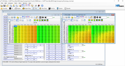

after making the changes i saved the file, loaded the tune in my PCM/TCM and took the Durango for a spin.
The result she now makes a 2-1 downshift at around 3-4mph when slowing down with the output shaft RPM falling below 150rpm
Again i only used 150rpm where the 7rpm values were located before in all those tables pretty much still following the factory approach.
Before:
I had to be fully stopped for the trans to go in 1st gear basically from a coastdown situation.
Now she does the 2-1 downshift once the output shaft rpm have fallen below 150rpm, which can be around 3-4mph. Shift is not abrupt and makes a nice difference to be in 1st gear when you give her gas after slowing to about that speed from a slow corner where you have to look left and right before making your right turn for example and you didn't do a full stop.
I changed:
Before:
