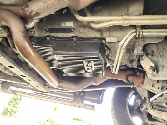

Here is the pic of a PPE pan installed. Notice the location of the drain plug.

Mine's here and painted, but I need to get a new o-ring for the drain plug. It was out of place a bit and pinched. Waiting to hear from PPE if they'll send me one, but I'm just going to find one local (25mm ID, 3mm thick).

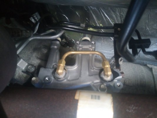

Installed the heater delete.
I debated on doing something similar but drilling it out to a -12an and running new an line all the way to the front and putting in a standalone radiator for the trans with a 160° in line bypass thermostat
