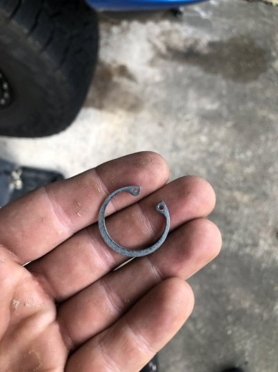

Welp, just shot my snap ring into orbit...wasn't having any success getting the thermostat out and was going to give up and put the snap ring back in...
Anyone know the size of the snap ring?
Edit
Happy Dance!
Decided to try my luck and started foraging in a bush in the direction on launch and dumb luck found it!
Going to by a lotto ticket now.
Orrr get back to trying to wiggle this thermostat out.

What if you try using super glue or some kind of plastic epoxy to glue something to the plug to give you something easier to grab on to. Plastic epoxy would be my first choice as I’m not sure how well super glue will adhere to that plug. Or if you can drill a small hole in the nub and put a small screw in it.
I ended up getting it out, more so ejecting it out followed by what seemed like a geyser of fluid. Certainly didn't seem like a few ounces.
Wondering if I should follow the fill procedure to check the level...

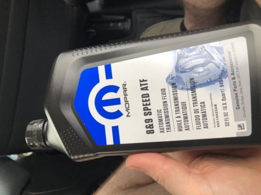

caulk04
caulk04
Supporting Vendor
Mar 24, 2013
1,104
2,458
What was your local price? I haven't stopped locally yet, but I've spent time looking online and it seems just as easy to get the Mopar fluid vs getting the ZF Lifeguard 8 online. Seems the best you can do online is $20/qt
