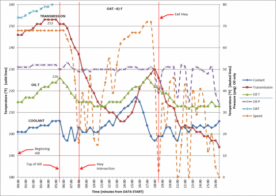

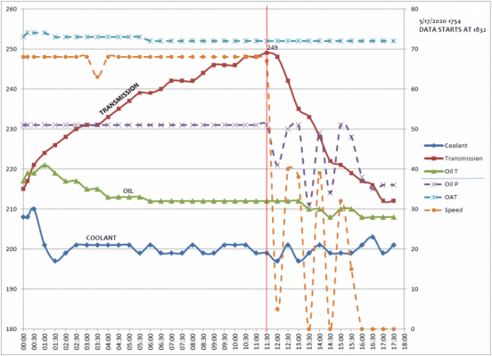

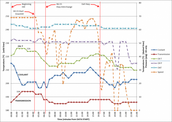

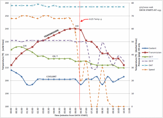

Here's a follow up to post #420 / 421:
In post 425 I stated that ~28 fl oz of excess transmission fluid was removed while following the transmission fluid check provided in this thread (key is the leveling of the tranny pan and pre-test setup). After conducting some test runs to ensure there were no issues (i.e. removing too much fluid) I drove the vehicle on a route that I had previous data on. The results are:
Before fluid check
@ 68 mph: 226F Oil, 217F Coolant, 253F Tranny
After fluid check
@ 68 mph: 226F Oil, 212F Coolant, 194F Tranny
Big change in tranny temperatures and slightly lower coolant temps. And this is consistent on all trips since.
Lessons learned: Double check the work done by someone else on your rig.
Here are the graphs that go with this data. First is the before fluid check run:
Next is the After fluid check run:

@Fritter, am I right that your experimenting suggests that your transmission was overheating due to an over-filled transmission? Let us know if you see it overheating under any other circumstances. To date, I've only been driving mine around in the city, and it gets up to 188 F, but that's about it. Pretty boring. I can't wait till I have some free time to fiddle around with mine.

Dan, you are correct. In my case based on the evidence to date, a significant causal factor in the overheating is the excess transmission fluid. The only changes to the vehicle between the two graphs is mileage, 2 engine oil changes and checking the transmission fluid fill level (with the subsequent removal of 28 fl oz.). How it got that much excess fluid is unknown but I've envisioned a scenario during the initial installation of a replacement tranny back in 2018 due to infant mortality as the potential culprit. If the excess fluid started frothing then the heat rejection capacity of the system via the transmission oil cooler is drastically reduced. And the capability of transporting sufficient tranny fluid (i.e. heat) to the cooler is reduced. The cooling system is designed to work with a homogeneous fluid in a liquid state - not an air & oil mixture. That's the working theory.
I need to take a longer drive at steady highway speeds to ensure it is a true reduction in temperatures, not just rate of change difference. There are some increases in temperatures that did not level off before I had to reduce speed due to traffic. I want to get the vehicle up to a steady speed and hold until the fluid temperatures are stable for 10's of minutes.
On another front - I've looked at the impact of disabling the AGS (by pulling the fuse). There is ~10F drop in the 3 fluid temperatures (oil, coolant, transmission) in the examples to date and the short term variation in temperatures is less. This was during a 1 hour drive (multiple occasions). The temperatures appeared to be stabilized in the case of the AGS disabled but the AGS On case had increasing temperatures before needing to slow down due to traffic. Again, I'm going to need a longer drive to confirm.
