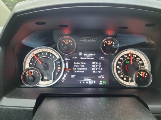

7 hour freeway run today. Virginia to Tennessee. 71 degree weather, limited traffic,
Check out these temps
That's still crazy how high your oil temp is though.
With a 180 Themro, shutters removed
Trans temp is around 145 on the highway
Oil temp is 190-195. That was a few weeks ago on a 85* day at 75mph
Since the 180 thermo I've never seen much over 200* on the oil unless I was running WOT a few times.
and this Stant 180 T-stat is the most consistent T-stat I've ever had. It will stay at 185* and never move unless I'm sitting in traffic a while.
I've ran several different kinds in my Orange truck including stant they would fluctuate so bad.

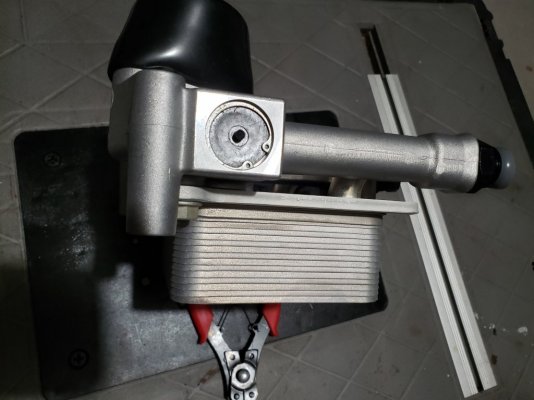

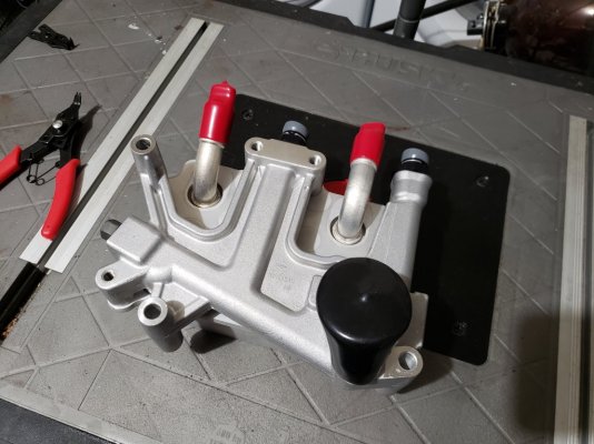

So after reading @hawsk99gt 's report of the persistant overheating problem even after installing one of @caulk04 's bypass plugs, it occurred to me that if there IS an internal problem with my transmission, installing the bypass plug would only mask it by substantially lowering the temperatures, and I might not ever know there was an internal problem, and thus internal WEAR, until much later once much more damage may be done.
So, I decided I wanted to know if it was indeed a faulty thermostat, bit the bullet, and purchased a new one, and unfortunately it comes with an entire thermal exchange unit attached to it.
Now, I own a cheapie pair of retaining ring pliers with adjustable jaws for various angles, but the jaws have a lot of play and for the life of me I can't get enough of a grip on the snap ring to pull it out. I heard someone mention a "good" pair of pliers must be used. Does anyone recall what brand/style those were? I may be looking for a good pair myself. If I can't get this thing undone on my work bench with ease, I don't stand much of a chance wedged up in the underbelly of my truck.
