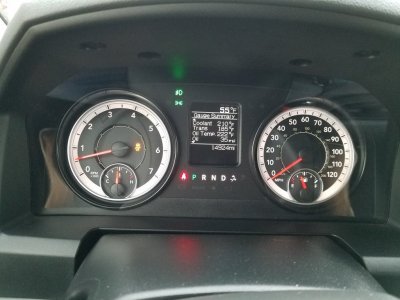

my truck is a 2014 Express with the 5.7/8spd, trans temps 185-190deg normal operation range
my buddies is a 2015 Express with the 5.7/8spd, trans temps 165-170deg normal operation range
both on factory fill
was there a hardware change between 2014 and 2015? Seems odd my trans runs so much warmer.
Thoughts? Info?
