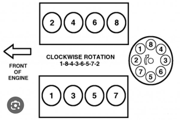

The engine needs an O2 sensor. You need to install one if it was removed. It should be in the Y-pipe upstream from where the cat was.
The black smoke and stumbling are indicators of misfire. Either flooding injector or bad ignition wires or plugs. If it looks like it was changed recently, triple check check Firing Order and placement of the spark plug wires. The last guy very well could have say wires 3&5 or 4&6 for example mixed up. Check them all.
