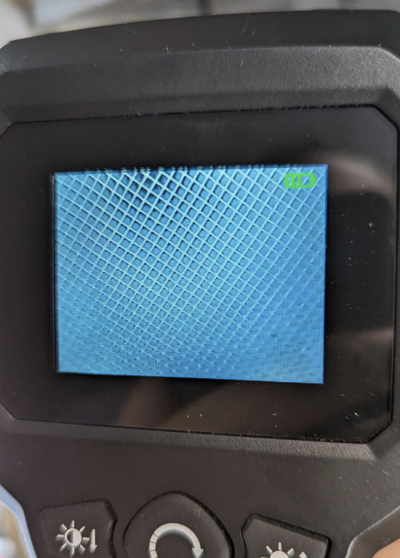

-Borescope inspection of cat (attached image)

Attached image is borescope view on catalytic, looked very clean and the same from each end inside
