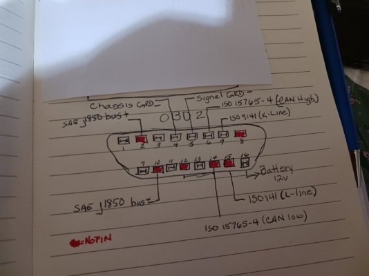

Update: I’ve been doing some research (correct me if I’m wrong, PLEASE), and found the OBD2 port can run off fuse 5 Cigar Lighter, fuse 7 Radio, or fuse 9 Engine. All of these fuses are good and receiving power. The truck doesn’t have a lighter or radio so I couldn’t check those. When I pulled fuse 9 with the truck running, it shut off.
I found a diagram online of the OBD2 Port in an article about diagnosing OBD2 that indicated to check the port PINS. Which I did and I am thinking the port needs to replaced? There does not appear to be any pins in number 2, 8, 10, 12, 14, or 15. I’ve attached a drawing of my port.
Any help is greatly appreciated.
