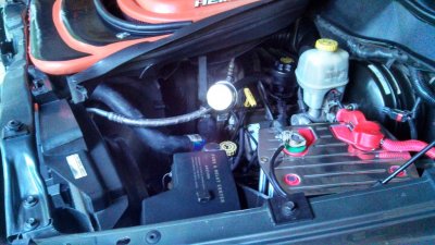

If your low on refrigerant, you have a leak somewhere, it doesn't just dissipate. I noticed some of my lines were sweating a few years back and knew that I was losing some efficiency through the condensation so I wrapped all the lines that were sweating with aluminum HVAC tape and boy what a difference it made in the cabin temperature! No more condensation either.
