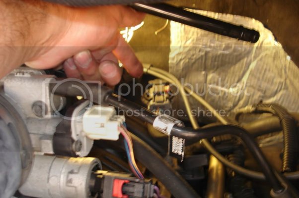

Sorry guys I forgot about the pic...but heres one I found on Google...
intoxicated, mine only cost $39 at Advance, then I used a coupon code to take another $9 off of it...So I only paid $30 for it.

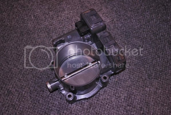

And yes, that is the throttle body, mind you the 07-older 4.7 don't utilize an electronic throttlebody like yours does.
I think we still have the regular throttle bodies, IIRC, just the Hemi has the electric ones.

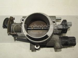

Yea i have the 07 4.7 and im installing the 08 intake manifold. But i do have the cable driven tb. I just had to buy adapters for the tb bc the 08 has 4 mounting bolts vs the 3 on ours.

yea my tb looks like the bottom pic. i looked again for the egr i see it but holy **** is that tooked in there. i cant even get my head that far back to the firewall to begin to see it. i hope there is some more daylight from the bottom up since im lifted maybe there som gaps. yikes. imma leave that to a pro
