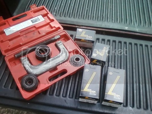

I did mine myself on my 96...the uppers and lowers are both pressed in on the earlier ones...used the NAPA Chassis Parts ball joints, after renting the press and all, I was in it for about $100...thats doing both sides.

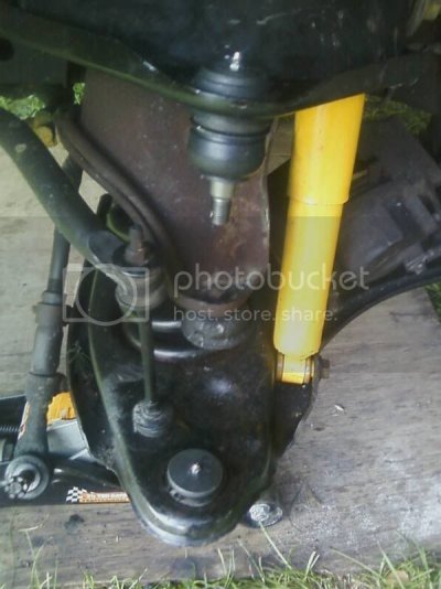

Here some pics of when I did mine...

On mine it fixed both...mine would be noisy as hell going over bumps and turning the wheel. I changed the shocks at first, thinking that was the problem, but it wasn't. Was told to switch out my ball joints, and did so....BAM no more noise. Mine got so loud, you could hear me turning down the street from a mile away.
